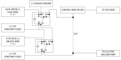

    2 Anleitung(English)
    The gist is to wire through the control lead (terminal #4 on the pump
    G/R in color) through the relays. If none of the relays are triggered,
    operation works as normal (ie. with the key). If one relay is tripped,
    we disconnect the control wire lead and route either +12v or GND to the
    pump terminal #4. Simple
